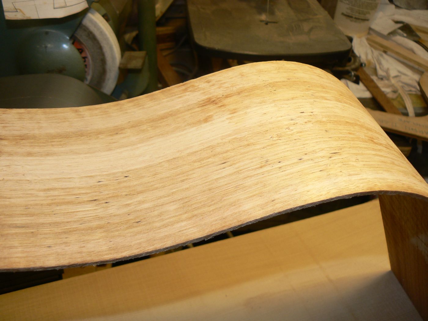

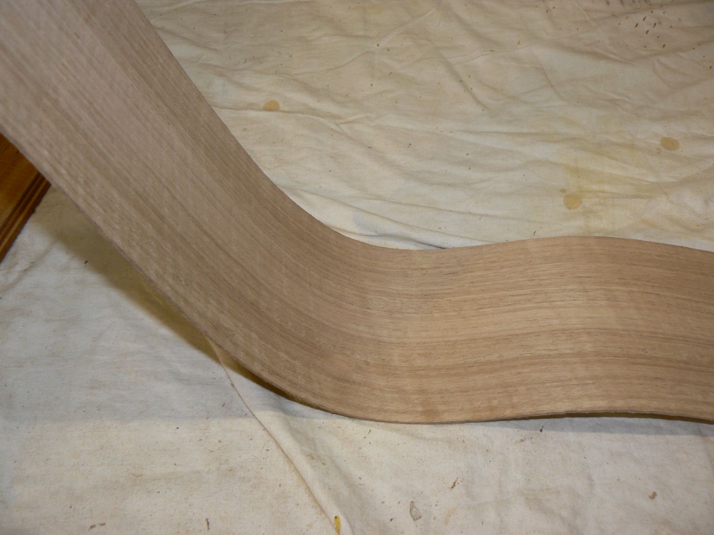

Here is a problem for all the experts. I recently bent sides of Alpine Ash (Eucalyptus Delegatensis) with added moisture (not soaked but wiped on) only to fine that the interaction between the timber and the side material produced some blue/black spots. I then bent the side without any added moitsure and the problem was resolved. Some I have spoken to over here mentioned that a specific type of paper has been used with timbers that have a tendency to do this. Any thoughts?

I see a grinder in your photo. Micro iron filings on your wipe down cloth from contamination surrounding your grinder area is my guess.

The side set was transfered from the sander to the bender with only one temporary stop on a set of chrome rollers. The slats were stainless steel so I am guessing that there was some interaction bewteen the additional moisture and chemical in the wood. THanks for all your thoughts on the matter.
